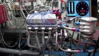

Post by Kazoom » Sun Jan 17, 2016 11:53 am
... compared to 690hp on PUMP GAS on a 400ci street/road r eng using a pc/avg xtc A3 type port budget Clev head casting a few years ago...
https://www.youtube.com/watch?v=FAVNzHLJ4GE
