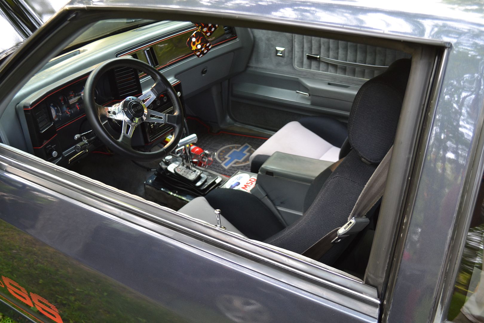

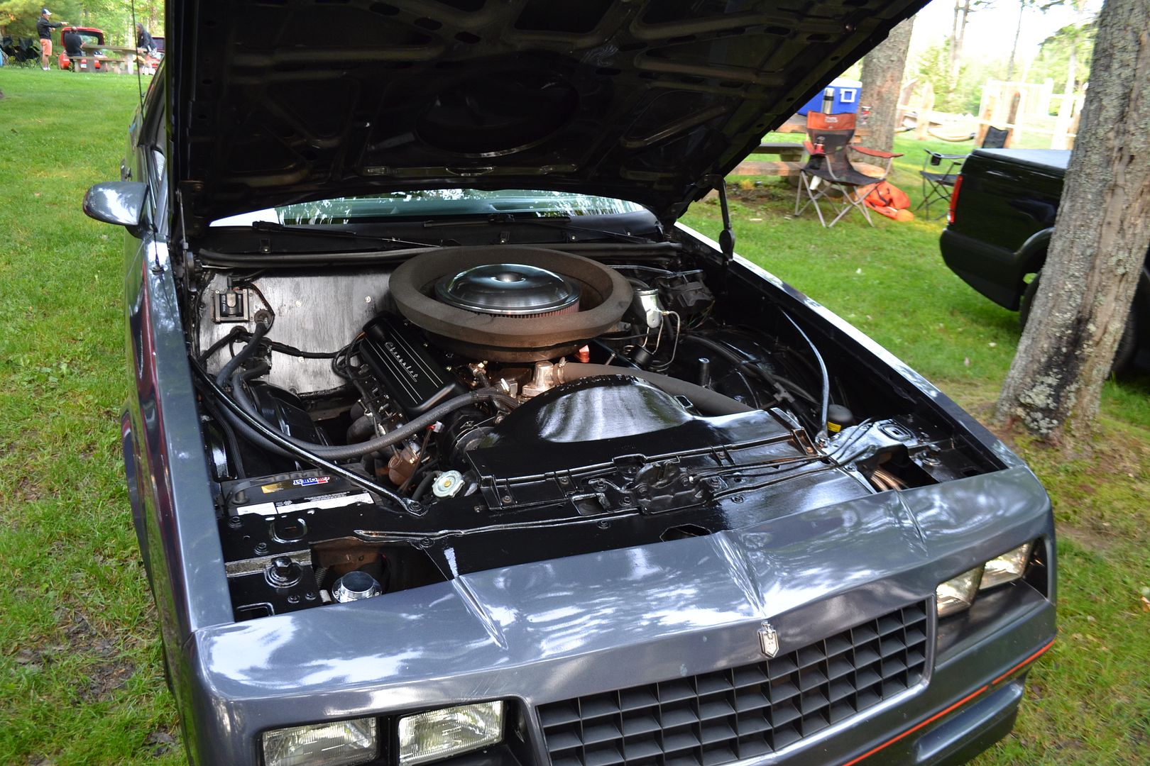

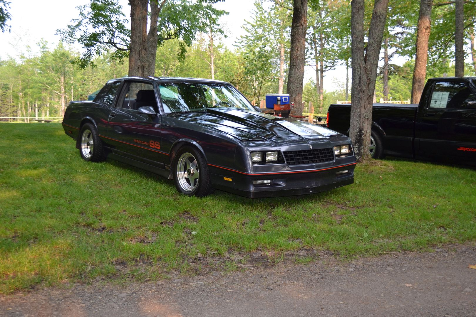

GuysMonteSS
Posts: 203
Joined: Mon Nov 19, 2007 5:35 pm
Location: Nova Scotia Canada
Re: Doug Nash 4+1 hard to shift when hot
Post by GuysMonteSS » Tue Aug 25, 2015 4:22 pm
Here's a few pictures;
The firewall flex is on my "to do" list.
It's good to know there are other options with bellhousings and clutch fork's but everything is working real good now so I will probably leave it |as is".
I sure am glad that I fixed this issue.
It was getting so I hated driving my car,now I love it :D
Thanks to everybody here for all the help !!
Guy
