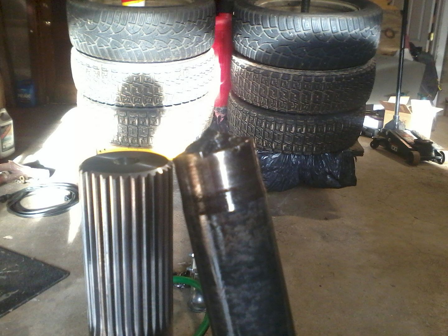

The math in the thread does make me feel a bit better though. When I compared my old 26 spline axles to my new 31 spline, I had a sinking feeling because they aren't visually that much larger.
Knowledge that people run 31 spline axles in cars weighing 1000lb more and making three times the horsepower is academic when you're trying to keep your car from breaking, you know? I lost a whole season due to axle failures.

If I'm right, your new 31 spline is 69% stronger than the old 26 spline.
Here's a chart I wrote.
