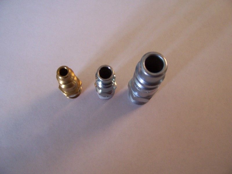

by BOOT
Took a pic to show a friend on FB so figured I'd share it here as well.
Left to right 1/4 M style, V style(3/8 M style), 1/2 M style

by noice
Sometimes it is the fittings that can restrict flow, many of the quick connects actually suck when it comes to this. The male end might be unrestricted, but the female end has a spring loaded plate that the air must flow around to continue downstream.
Since most every air fitting is made this way, I like using lincoln style air fittings that you can plug in with one hand.
However the most crazy fitting I've ever seen is a true full flow fitting that can be plugged in with one hand, I don't even know the cost. They are called ErgoQIC full flow fittings by Atlas Copco. They also make crazy expensive air tools that have turbines in them instead of typical air motors.

by BOOT
hmmmm never considered the couplers might be a choke point, suppose it would be possible to connect the line to a T or distribution block and then even just put the line straight into the impact since I'd only use the larger line with that gun. I'd at least put a shut off valve on the tank end.
