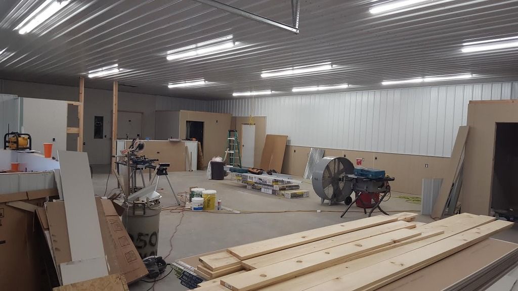

Post by cspeier » Wed Oct 21, 2015 12:22 pm
Picture of interior. Dry wall will be finished this weekend, central heat and air (round duct) will be finished first of next week. I'm all wired. Paint on walls and floor and I'm moving in.
Just my dad and I have done this. Way too much work. I think it about killed him!

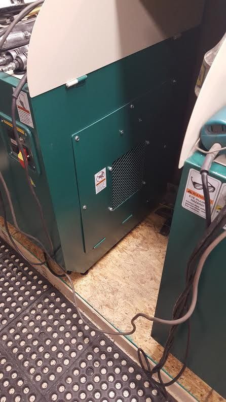

Gaining on the duct. Porting bench.

Your shop looks real well thought out . Something i saw and wondering about your Grizzly down flow bench looks to be up against the wall behind them are they exhausting into a area behind them as the info on there web site says you most be 12" from a wall

winterhoff wrote:Chad
Thanks Ron
Thanks Ron!
These smaller units exhaust from the side. The larger unit exhausts from the back. That is why I went with two smaller benches.
